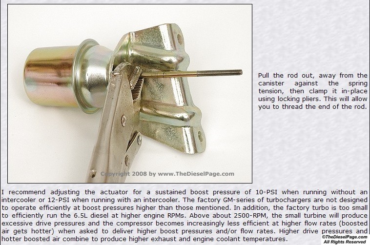

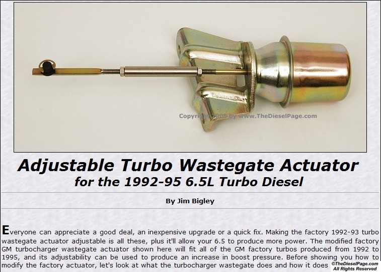

    Thumbs up Free Stuff!

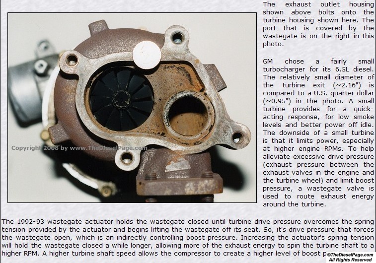

    One of our members, Pete Jadwinski, has graciously volunteered to produce a kit for TDP members that includes the threaded sleeve and jam nuts. The Diesel Page will give away (as in free) the first dozen sets. Thereafter, you'll be able to order them at a good price directly from Pete.
    If you own a 1992-95 6.5L diesel and you'd like to be among the first dozen, send me an email.
    Jim

    You'll need a 1992-93 factory actuator to work with this mod. One of these actuators would bolt right onto your turbo (replacing the one you have now). Unless you have a 1992-93 actuator already or can get an inexpensive used one, there are better options. As far as the vacuum system, some computers aren't all that finicky when installing an adjustable mechanical actuator - some are. Some of these are helped with a boost fooler or a program that compensates.
    Perhaps the best choice for the EFI systems is a chip that does it all - more boost pressure (via the factory vacuum actuated controller) and more fuel.
    Jim

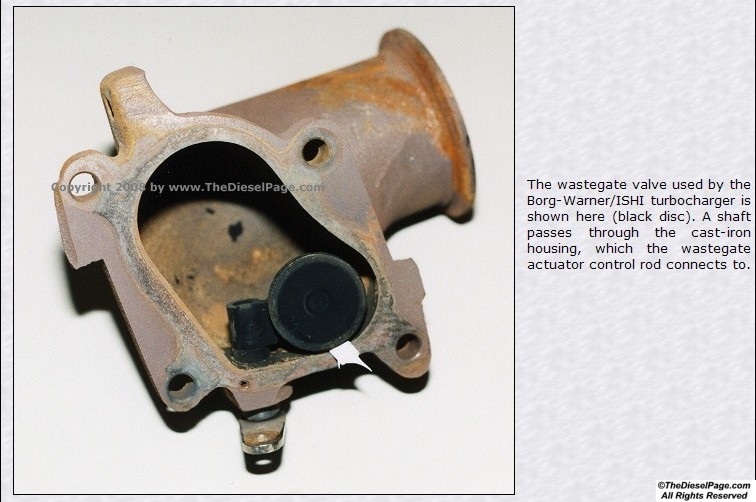

    A friend called me late one night with a serious issue with his waste gate.
    Seems the diaphram had gone south and the waste gate was hanging open.
    This was quite disturbing as the EGT's were going through the roof while pulling grades. (He was towing a camp trailer 20ft ??? )
    The issue was, what could be done out in the middle of nowhere???????/
    I advised him to rummage the tool box and see what he had available.
    A few minutes later he calls back with a list of items available.
    1 Bungy cord, YESSSSSSSSSSSSSSSS Found laying alongside the rig at the truck stop while getting some chow.
    Hooked to the wastegate arm and tied off to a suitable spot in the engine bay, the little rubber band got the job done quite well, and with a little adjustment worked for the remainder of their trip.
    A few SES lights due to excess boost but easily reset on the fly with a restart.

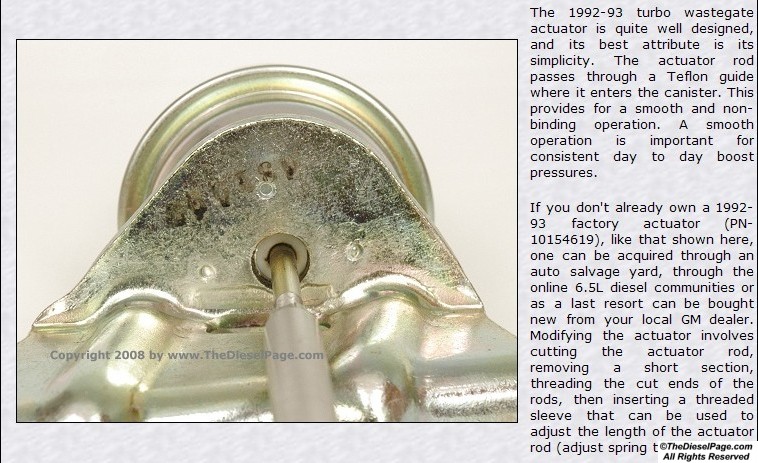

    so if i'm reading right:
    i install the 92/93 actuator and DO NOT hook vacuum to it. correct?
    how come i cant use the 94/5 actuator. kind of new at this whole "diesel" thing
  19. #19
    Join Date
    Apr 2001
    Location
    CA
    Posts
    13,579
    Arrow
    Quote Originally Posted by Wing Nut OOA View Post
    email sent.
    this looks good.
    The 92/93 actuators are not vacuum controlled. Spring tension only. 94 and later are vacuum/PCM controlled. If you use a vacuum actuator, you will still need vacuum (the vacuum is the spring, so to speak).

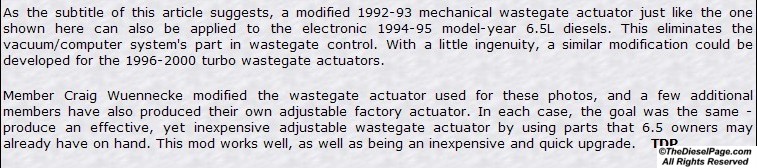

    Has anyone modified a 94-95 to work with one of these? And if so do you have any pictures of what is needed or possibly a good write up?
    I picked up a 94 Suburban yesterday, so maybe if I poked around long enough I could figure out what needs to be done, but this is my first diesel, and my first turbo.
