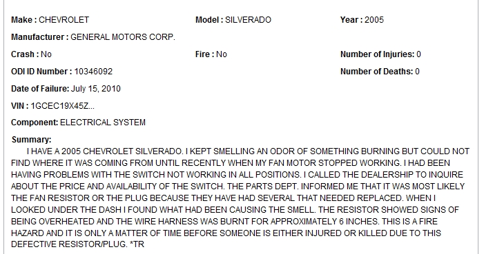

    Transport Canada Recall # 2011074 Recall Date 2011/02/21 Notification Type Safety TC System Heater And Defroster Manufacturer Recall Number 11046 Units Affected 190,310 Category Light Truck & Van, SUV Recall Details On certain vehicles, the interface between the electrical terminals of the Heating, Ventilation, and Air Conditioning (HVAC) blower relay resistor module and the wiring connector (which powers the module) may be incapable of conducting higher current levels for sustained periods of operation. In addition, moisture and other contaminants (such as road de-icing materials) may enter the fresh air intake plenum and contact the internal circuit of the module or corrode the terminals. These conditions may cause the relay resistor module or wiring connector to overheat, causing various symptoms such as: the HVAC blower may not function on certain or all blower speed settings; a burning-plastic smell or smoke may be present in the vehicle, or; the HVAC blower may run continually with the ignition in the OFF position. These warning signs could, in certain instances, be leading indicators of an impending vehicle fire, which could result in property damage and/or personal injury. Correction: Owners will be provided with additional warranty coverage for the blower motor resistor module/wiring connector overheating condition. Under this "special warranty coverage", should this condition occur within 10 years or 240,000 km from first vehicle registration, dealers will install a replacement blower motor resistor and resistor module connector. MakeModelModel Year(s) Affected CHEVROLET AVALANCHE 2003 2004 2005 2006 CHEVROLET SILVERADO 2003 2004 2005 2006 2007 CHEVROLET SUBURBAN 2003 2004 2005 2006 CHEVROLET TAHOE 2003 2004 2005 2006 GMC SIERRA 2003 2004 2005 2006 2007 GMC YUKON 2003 2004 2005 2006 GMC YUKON XL 2003 2004 2005 2006

    The three most ridiculous things about this recall are that there has been complaintsabout this online for some time at carcomplaints.com since at least September 2010 and on NHTSA since July last year.

    Default Blower motor fire
    Thanks for posting this information! It was 28 deg. this morning in northern California, and when I was defrosting the windows on my 07 Silverado 1500, with the fan on high speed, white smoke started to fill the cab under the glove box. I turned the fan off and even pulled the key but it was still running and on the verge of combustion. Fortunately I had a crescent wrench under the seat and disconected the battery, and saved the truck. After a google search, I found your forum, as well as many other similar incidents on other web sites. Thanks for alerting us to a recall (no thanks to GM). Can anyone tell me which fuse to deactivate the power to the blower harness? I have the diagram inside the fuse box, but can't determine the right one. I would like to be able to drive to a service dept rather than involve a tow.

    13,804
    If it's a recall under warranty, the dealership will arrange for a tow at their expense. Call them and explain the situation. I would not suggest connecting the power. Let them do it, after fixing the problem.
