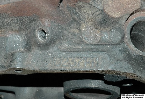

    What can you tell us about the following number?
    13,804
    It verifies a 6.5L casting. After the 599, and before the 929 and 506, with no piston spray, and no heavier bore casting in the rear cylinders. Probably the "weakest" of the non-spray castings. A good choice for N/A economy use, as it a little lighter than other castings.

    I would probably have guessed 141 suffix was BETWEEN 929 and 506, but may well have been wrong, it wouldn't be the first time.

    I too thought that the 141 number was between the 929 and 506. The only thing I've ever seen a 141 in is an early '96 without the cooling upgrades. As best I could tell the 141 was almost identical to the 599 except for the oil pressure sender location and a couple of minor details. I also thought that the 929 number was the GM goodwrench number that was equal to the origional 599?

    I have a 929 block at the machine shop right now that is a 1995 casting out of a 95 truck. So I would have to argue that the 141 came after the 929...

    '141 is a 96 block with the 3/8" cooling lines. Has the boss in the back of the block that is just like a Hummer/Gvan turbo engine, but nothing is drilled or tapped (yet).
    Have one identical to it sitting wrapped up.
    Just like a '599 or a '929, just another year, but with the '97+ capabilities as far as rear mounted turbo.
    I'd wager a bet that this block was also used in Hummers that used the turbo starting in '96, but w/o the piston oil spray coolers.

    The casting numbers are just that, casting numbers. The castings overlapped, depending on application. GM didn't stop one casting, and start another. Newer castings were started and implemented, while previous castings were still in production. If this block was a van/HMMWV application, that's likely what happened. Older casting in a later model. The order of casting I was refering to was the actual full number. The 141 castings began before 1996, and other castings were made during that time.

    In my experience with casting design and manufacture, it is unlikely that multiple castings were made at the same time. Some new old stock might have been used after a new one was introduced to foundary production, however. When casting changes are made, the tooling gets modified making it very difficult to go back to the older configuration. On occasion, an insert in the tool can be used to allow multiple design configurations, but this is costly, lowers precision and opens the door to parts with the wrong features. Looking at these blocks, I can see no evidence of inserts being used.
