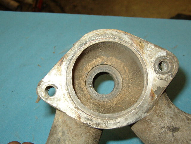

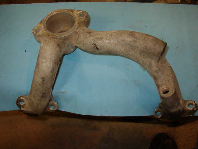

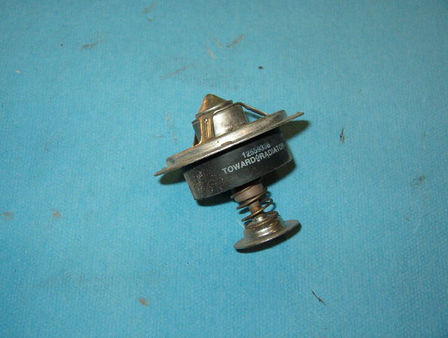

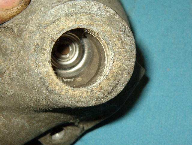

    Do a search on this subject. There has been much discussion about it. I posted some pictures once that show there is a significant increase in flow area both through the thermostats and through the bypass with the new housing. GM reported popping freeze plugs when running the new pump with the old crossover. There's been lot's of argument both ways.
    I ran an HO pump with a single thermostat system in a 1994 K3500. We later removed the thermostat completely and it ran much cooler all summer, and still made good heat in the winter while plowing.
