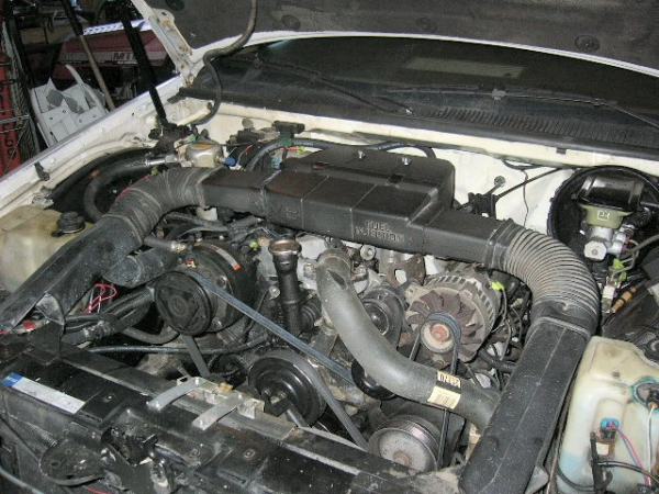

    I really enjoy checking out these "outside the box" conversions that people are doing. Dare to be different! and all of that...
    So the stock suspension doesn't have a problem with the extra weight?

    Suprisingly, with the added wieght, the front only dropped about 1/4 inch, and that was with old springs! I will be replacing the springs this year and hopefully that will return the ride hieght. Another plus is that the car rides better even then in it's stock form, which was already smooth. Nothing like cruising down the highway while sitting in your lazyboy. The sway bars are already oversized for the car and have no problem handling the diesel.
