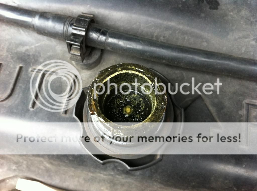

    Bear with me as I get to the question - just want to provide as much info as possible...
    I've always had a little tiny coolant leak (from some bolt on the back side of the port-side head?) since the engine was rebuilt (about 53K on the rebuild). No big deal as it would take 5K miles (give or take) to get to the point where the low coolant light came on. But recently the rate of loss has sped up. I initially thought it was just an air bubble as I had to refill again after less than 50 miles. But I just had to refill again after the same, less than 50 miles.
    It is NOT showing up on the driveway (like that pesky little leak would) and oil level has NOT increased. In fact, it's a little low - but the engine always seems to eat a little oil since the rebuild. Less than one quart over 3K miles. With 2K miles on the current oil change, I'm down about 1/2 to 3/4 quart. The oil looks the same color (black) as it always does. Again, oil level is NOT increasing.
    It is not in the ATF - that looks nice and red.
    So this brings us closer to my question. As I was refilling the coolant (cold engine - about 45* ambient) I decided to also open the bleeder screw. I happened to have the dipstick out (engine was running) and noticed that there were puffs of greyish smoke coming out the dipstick tube. I closed the bleeder and the puffs went away. Opened the bleeder and the puffs came back, closed the bleeder and they stopped, etc.
    I went for a short trip (10 miles) and when I came home I removed (engine still running) the oil filler cap. There was a small amount of greyish (maybe whitish) smoke coming out of the filler neck. I put my palm over the filler neck for about 10 seconds and there was no oily residue or discoloration to my hand. And then I looked at the underside of the cap. I use orange Dexcool. The cap smelled slightly sweet and so did the smoke coming out of the filler neck.
    I am immediately thinking head gasket (but I am not an expert on this matter, by any means), but am wondering if that is the only possible cause as this engine was built to handle 25+ PSI by Ron Schoolcraft (If I remember correctly, he used ARP studs, for example). There are no drivability issues and all gauges read normal. About 53K miles on the rebuild. I'm going to look around for a local oil analysis company (for time's sake).
    Any and all thoughts are welcome! And... I won't be driving it until I at least figure out if the coolant is getting in the oil as I assume that's pretty bad for an engine. Here is a pic of the filler cap:

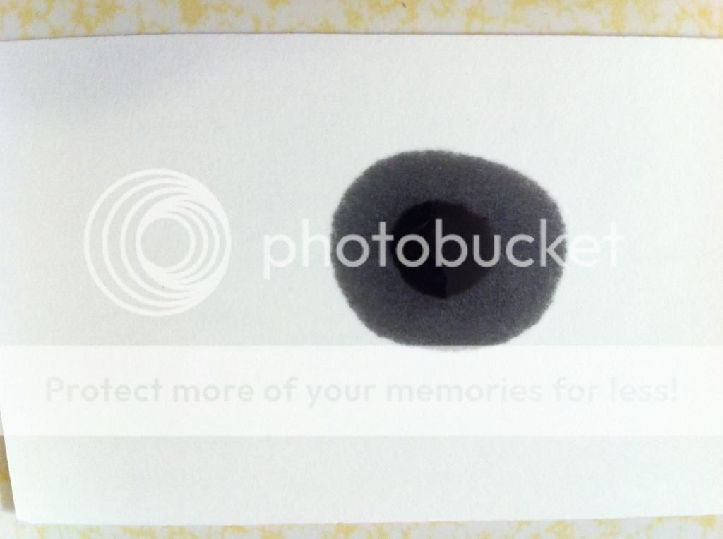

    I drained about 3 ounces of oil from the pan into an old baby food jar. I then put one drop onto a business card. This picture is after it soaked in for about 2 hours. The oil that I drained into the jar seems of normal viscosity and smells only of oil. There is no sweet smell to it - perhaps I mistook the smell I smelled earlier?

    Get the oil tested for glycol first.
    The loss of coolant is always spooky on these beasts.
    The come and go of smoke from the crankcase/oil fill when the coolant air bleed is opened and closed is ominous for sure.
    The lack of leaks on the ground makes it even more ominous.
    NORMALLY, a coolant leak past a head gasket will also show pressure in the cooling system with the HARD top hose symptom and coolant being blown out over the pressure cap.
    My next question is what year is the block and the casting number ????
    If this is a factory 98 block from the Burb in your signature
    Two very bad scenarios come to mind.
    A cracked #8 cylinder near the top deck. 97 and later blocks were common.
    These can cause coolant loss into the cylinder and leak into CC too.
    The cracks will tend to seal upwhen the engine is hot.
    A crack that started in the main web and has crawled up into the lower end of a cylinder allowing a slow coolant leak into the bottom end.
    Get the oil checked, then let us know.
    I hate to throw cold water on the camp fire, but this situation looks ugly at present.
    Get more data and we can move from there.
    Allow the rig to sit over night, yank the #8 glow plug, unhook the IP shut off Sol, stuff a clean paper towel up by the 8 hole and crank the engine.
    See wassssssup, if there is red coolant on the towel there is trouble in paradise.
