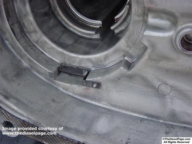

    In the above photo the spring that came loose or broke off wore a small hole at the indention left and back there you see the wear.
    Above and close to the center of the photo you can see the hole about 3 inches above the 3rd bolt and right below the dirtiest part of the case.
    Just picked up truck from service dept. with a $1,280 bill.
    The problem was a spring came loose from fluid pump inside the transfer case and caused the tention to wear a small hole in the rear half of the transfer case at the drive shaft.
    Steve

    Mattb, there is a broken clip inside the TC that is wearing the whole in the case.
    The fix is a new rear case half and clip. I would have the dealer do the repair right.
    There are trucks out there that are destroying transfer cases because they are loosing fluid through these wear holes. It is more of a problem than people think.

    IIRC, there is a clip that helps hold the pump in place that can break and let the pump rub on the inside of the transfer case eventually causing a tiny hole in the area you have described. Some people have patched it using JB Weld, some have had a welder patch it, others have bought new/used transfer cases since theirs had no fluid in it by the time they found out. I am not sure of the best fix (if there even is one), but try using the search feature and maybe you can get more info. Sorry for the bad news.....

    Red and MP have the answer. I discovered mine leaking a couple weeks ago during a oil change. New case half should be here today. Looks to me like JB weld or similar would only be a temporary fix. It would wear through soon without that metal tab to protect it.
