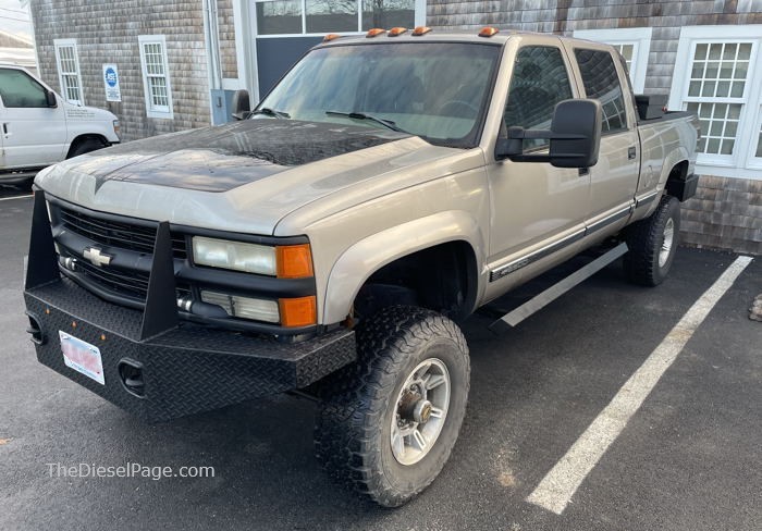

    This above message was posted in may of 2021... just about 2 years ago. I received an update from Patrick a few days ago, along with an order for another set of our conversion mounts. I like his truck's new hood! Here's what Patrick said recently:
    These mounts are actually the second set I’ve purchased.
    A couple years ago I bought a set to put an LB7 in a 2000 K2500. I chose not to body lift it and instead made a HD hood. Attached is a photo of that truck.
    I’ll keep you updated on this trucks swap.
