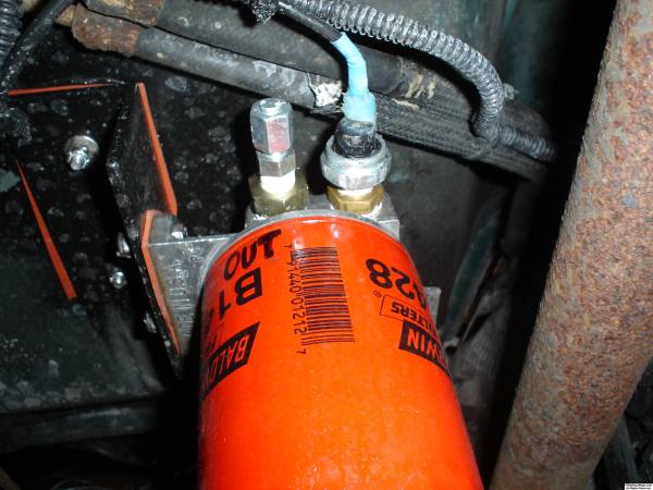

    Is there an easy way to verify what my oil pressure gauge is reading? I installed a remote oil pressure sensor, wired up to a light on my dash. The remote sensor is *supposed* to be calibrated at 20psi. However, according to my stock, dash gauge, the extra light I installed comes on once the pressure drops to about 30-32 psi. I'd like to figure out which is correct - the stock, dash gauge or the new, remote sensor.
    This picture shows the oil pressure sensor (blue shrink wrap):

    Ahhhh one of my personal questionable and still not satisfied understanding of oil flow specifics.
    How long have you been running the warning light and has it worked as intended before?
    You could rig up a cheap mechanical guage to that port and see what it sees for pressure. That would diagnose the warning light function. Depending on speed of switch see below.
    Find out specifics for the switch function does warning light come on at instant of 19.99 psi and or 2-3 seconds of <20 psi and it turns off with 2-3 seconds of >20 psi etc that might make a difference. Are you measuring the pressure pre or post filter media? That could dampen pressure spikes of oil flow especially as media plugs more. My guess is the complex flow path and bypass valves are messin with the light. If you measure downstream of filter and bypass's in an oil gallery I bet your oil pressure is close to what your dash gauge reads.
    I personally don't believe 100% of the oil goes through the filter or cooler for that matter in normal driving 100% of the time. But I won't tangent for now until I understand more of your problem.

    Also explain how its worked so far.
    I interpret light goes out when dash gauge reads above 32 psi. Is that cold and you are reading what about 60 psi idling then warm it dips to 30 ish psi idling and up to 50-60ish at 2000 rpm the light goes on and off depending on what???

    Couple of things to consider:
    The oil pressure depends in part on where you measure it. Don't expect 2 sensors at different places in the engine to read the same.
    The switch turns on and off in response to changing pressure. The gauge may respond more or less slowly to the same changes.
    10 psi at idle is more than enough. 45 psi is more than enough for all operations.

    What size hoses are you running to the filter?

    One thing I hesitate to question is how does that pressure switch work? Because I don't know exactly. Is it one wire one terminal or is it 2 hard to tell from pic looks like one wire and its suppose to ground to achieve ok signal. But looks like you have rubber for shock absorbtion in mounting filter head and again inbetween mount fixture and truck body so can it achieve good ground or is it open without vibrations or intermittents ???

    Quote Originally Posted by Hubert View Post
    Well, that's a good point - and a mighty keen eye, as well! Yes, it is a one-wire hookup. Yes, there is a rubber gasket between the mounts for vibration dampening. However, I think it ends up grounding through the SS lines. Now, I must say that this was not my intention. When I put this together I was well aware of how it's supposed to ground, but in the process I simply overlooked that step. Looks like I got lucky, 'cause the light on the dash seems to be working quite well - never any "intermittent" on time to indicate bad grounding. At night, it's awful bright! By the way, with the install of the new engine I cleaned all ground mounting points, replaced all ground straps with new/larger ones, and replaced all battery cables with 1-gauge. I even replaced the + cable that goes from the driver's battery to the main fuse box with a new cable about 2 sizes larger.
    OK, here's some more detail. I used -8 hoses as I was concerned about -10 possibly causing a slight drop in oil pressure. To keep things simple, I'll refer to things as "DG" (the PSI reading at the "Dash Gauge") or "RL" ("Red Light" on the dash, wired to the remote sensor).
    I just recently hooked this up with the install of the new engine (less than a week ago) - although I have been using the remote oil filter for some time, just not the oil pressure sensor. So, I don't have a comparison. What I can say, is the DG seems to operate the same as it did before. Meaning, how quickly the needle reacts/the extent of the high and low swings/what the PSI reads when the engine is cold or warm/how the needle reacts to RPM's. So it seems as the DG is operating exactly the same as before.
    At cold idle, the DG reads close to 60. At warm idle, it reads about 25. So once the engine warms up, then the RL will come on at idle. After the engine is warm, if I increase the RPM's to about 900 the RL will go out. This corresponds to about 32 PSI on the DG. The RL will come on and off very quickly - faster than the needle swings.
    By the way, the pressure sensor is actually located in an "IN" port on the filter mount as I'm intending the other "OUT" port for a bypass filter. However, my thought was there should still be the same pressure at the "IN" port since fluid takes the path of least resistance. I discussed this with a guy at my local injection shop and we both agreed. Does this make sense or am I missing something?
    I guess what I need to do to really know for sure is hook up a mechanical gauge (as suggested above) where the sensor is? Is there a better place to hook up a gauge?

    The -8 lines should be fine. A -10 should not drop psi as it's just a vessel carrying oil to the point of leak which is the bearings...

    I don't think the oil filter bypass valve should be bypassing under normal circumstances. If it is, unfiltered oil is getting to the engine.
    Put a mechanical gauge on both ports (one at a time) and get readings under comparable RPM and oil temperature and compare them. The accuracy of the gauge is not important; you're just trying to quantify the difference between the 2 positions. The panel gauge is nortoriously inaccurate; better for trend analysis than absolute readings.
    Unless they have come up with a new numbering system, a -10 hose is bigger than a -8 and would have less effect on pressure, not more, right?
    Having 2 oil pressure sensors is like having 2 watches. You'll never know for sure what time it is...
    Less than 20 psi at hot idle is not necessarily something to worry about.

    Quote Originally Posted by JohnC View Post
    Well, my thinking is that the larger the vessel (hose), the lower the pressure will drop. Same amount of fluid pumped through a larger tube will decrease pressure in the tube. -8 and -10 are awful close, so maybe the difference is negligible. As stated above, maybe it's not so much the size of the hose and more what's at the end of the hose that controls the pressure (unless we start exagerating the hose size).
