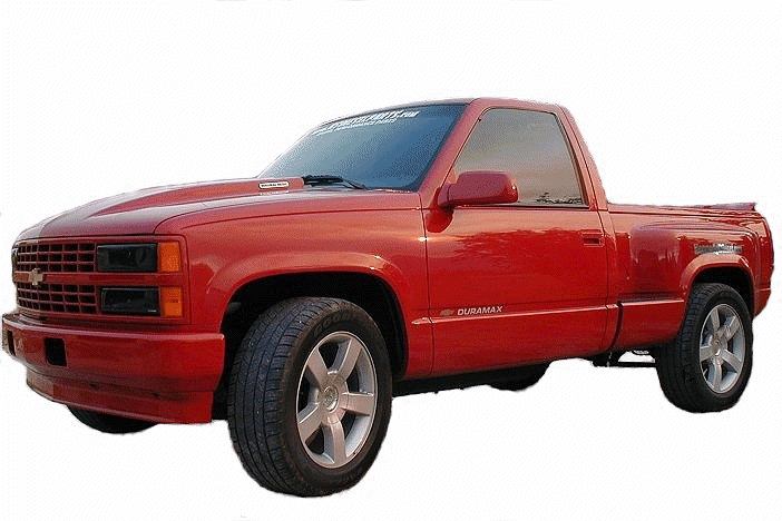

    Duramax Diesel Power Project
    Rocket science is a whole lot more entertaining when you actually get to drive one! The primary mission for this Duramax Diesel Power Project includes exploring the performance potential of the Duramax/Allison in a lightweight 4x4. This truck was first driven in April 2004 soon after completing the conversion.
    A wide range of Duramax performance products have been tested, and more are in the works, which help us explore the performance potential of the Duramax/Allison powertrain - both on the dyno and at the track. In addition to performance products that increase fueling and boost pressure, a nitrous oxide system was included in the range of tested products. Many of these product reviews are currently available online here at The Diesel Page which help to explain what we did and why we did it.
    A 4" exhaust system, 4" polished stainless exhaust tip and Bilstein HD shocks were installed in May 2004 after the body work and paint had been completed. A custom exhaust system was chosen because we needed a 4" tailpipe without pre-welded hangers to work for this rather unique application. There is no muffler or catalytic converter installed, which means the truck sounds a little more like a hot-rod. The addition of a set of CalTracs traction bars help control axle-wrap during a launch.
    After exceeding the power/torque limits of the factory Allison automatic, we installed an ATS Allison transmission in 2005. There are several different ATS Allison options available from mild to wild, and ATS set us up with what this particular truck needed. The new transmission shifts mildly when dialed back for daily type driving, but performs with authority when needed.
    Prior to May 2004, we had been looking for just the right set of tires & wheels before we finally settling on the silver finished factory Chevy SS 20" x 9" aluminum wheels. The matching Goodyear Eagle tires in 275/55R20 were an excellent choice, being almost 32" in diameter and more than 11" wide.
    The original 10-bolt ½-ton rear axle was replaced in late 2004 with a disc brake equipped six-lug 9-1/2" 14-bolt semi-floating rear axle. Our replacement axle was rebuilt with a new Eaton Positraction differential, new 3.42 ring & pinion and all new bearings and seals. Other than shortening the rear driveline about 3/4" and upgrading the rear driveshaft u-joint to a 1350, this was a bolt-in upgrade that has performed well in this lightweight truck.
    This project was about power and performance, but it also provides a tremendous opportunity to learn more about the powertrain in the process. The payoff is all of the new articles and product reviews that result from the buildup and testing. Aside from providing more interesting content for the web site, members learn more about product application for their own trucks, and manufacturers/vendors gain exposure by sharing their knowledge and expertise. Everyone wins!
