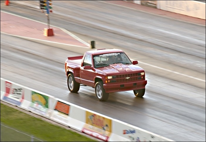

    Talking Update 3-21-2024 - Diesel Performance!
    This video was produced some years ago, before diesel performance programming could produce power without smoke and while tires were a bit less expensive than they are now. Mind you, something similar to what's shown here can be seen today on nearly any performance automotive cable program or related Youtube channel. So... Lil Red hasn't produced smoke in years and tires are currently viewed as a more longer term investment...
    Except for imagining vvrrrooommm sounds, there is no audio. However, no pedestrians or cute bunnies were harmed in the making of this film.
    The following image was shot a few months after the above video was taken, only this time I was using a KennedyDiesel.com EFI-Live program that allowed the truck to dyno 500-rwhp. As you can see, there is no visible smoke shown here at the beginning of a 1/4-mile run.
    I was likely using a Van-Aaken performance module when the smokey burnout video was made. I liked that in-line module when used at lower power (no smoke) settings, and I used it for years in my 2001 GMC Duramax crew cab where it could smoothly produce more than 400 rwhp without smoke.
    Back in the early days of the Duramax I answered a few emails from young guys who wanted ideas for how to get their truck to produce more smoke... I tried to discourage the idea...

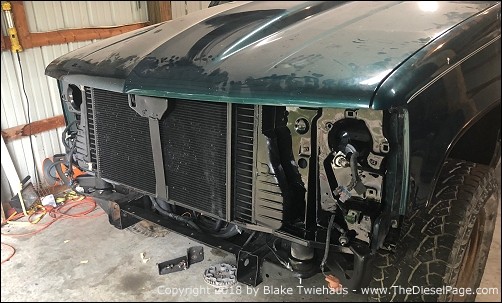

    Lightbulb Update 5/22/2024 - Lil Red's Duramax Conversion - Intercooler Details
    From the 2004 archive: These photos show the installation of a modified stock 1994-2002 Dodge intercooler - to give you some idea what the installation looks like in Lil Red. This Project Update will introduce you to the intercooler installation process, and illustrate some of the modifications necessary to install a 1994-2002 Dodge Cummins intercooler in a 1988-98 C/K pickup truck or Suburban.
    As it turns out, the Dodge Cummins intercooler core dimensions are exactly the same as the core used in a stock 2001-2004 GM Duramax powered 2500HD/3500 truck. At the time I put Lil Red together, I could not locate a used/salvaged GM intercooler, and was already over-budget on this project, so I wanted to cut costs where I could. A factory new GM intercooler was more than $600 at that time. So, the only reason I bought and modified a Dodge Cummins intercooler was because I was able to buy one on eBay for a lot less. A GM factory Duramax intercooler would have been my first choice otherwise, even though it too might need to be modified.
    The above photo shows what the modified Dodge intercooler looks like installed on the truck, but before the hood latch support had been modified.
    This intercooler was purchased from a seller on Ebay. I had been watching Dodge intercooler auctions for a few weeks, before deciding to actively engage in the buying process. Some of the offered intercoolers were removed from wrecked or damaged Dodge trucks, so you need to evaluate any intercooler offered to determine whether it remains usable or whether the damage was more cosmetic in nature. The one I bought did have some cosmetic issues, but was structurally sound and leak-free. Based on the auctions I monitored, you might expect to pay anywhere between $150 and $400 depending on condition for a usable Dodge Cummins intercooler and the whims of your bidding competitors.
    The Dodge IC core is approximately 15-3/8" tall, a couple of inches shorter than the available space in front of the radiator.
    The IC core is a little more than 2" thick, and will fit fairly well behind the hood latch support bracket in the space formerly occupied by the A/C condenser. The hood latch bracket must be modified to allow for a modified A/C condenser to fit ahead of the intercooler. I could show the A/C condenser mods in a future update if anyone would like to see how I solved that problem. Can't live without A/C...
    Aside from being 15-3/8" tall, the core is also 36" wide, not counting the bulk of the end tanks. A 36" wide core closely matches the radiator core width, and works well with the C/K OBS (Old Body Style) radiator core support. The total width, including the end tanks wound up being about 45-½".
    These photos show the mods I made to the aluminum end-tanks of the intercooler. As received, the Dodge intercooler's 3" inlet/outlet would need to penetrate the box-sectioned structural member on each side of the radiator core support. I decided not to weaken the radiator core support, which meant modifying the intercooler - i.e. moving the intercooler's inlet/outlet to be outside of the radiator core structural supports.
    Widening the intercooler end-tanks required adding material - I used 1/8" aluminum sheet material.

    Lightbulb 5/23/2024 - Intercooler Details #2
    This image shows more detail about how the intercooler end-tanks were modified. The intercooler's inlet and outlet were moved outward to clear the boxed steel sections of the radiator core support, and then the end-tanks were modified to help provide more clearance for the head/park lamp assemblies. A 4" hole needs to be cut in the radiator core support where the intercooler's inlet/outlet pass through.
    I made all of the cuts/mods to the original intercooler, then took it and the various pieces to a metal shop for aluminum TIG welding. If doing this again I'd buy my own TIG welder and learn how to use it. In the end there would be no labor charges and I'd still have the TIG welder... all for about the same final cost. And incidentally, once all of the mods were completed I flushed water through the intercooler in each direction several times in an effort to remove any debris that might have collected internally during the process of modification.
    I used the GM factory intercooler hoses, clamps and aluminum tubing produced for a 2001 model year Chevy/GMC equipped with a Duramax 6600. If you have a donor vehicle that'll provide all this, you're golden. You don't have to use the original factory parts, but they will make it just a bit easier. The factory aluminum intercooler tubing will need to be extended because of the widening of the intercooler inlet/outlets. This is a relatively easy process. I used 3" aluminum agricultural sprinkler pipe to provide the extension material. I still have about ~8' of this pipe laying around... if anyone needs some. The Conversion Guide shows how/where to add the extensions.
    Of course, there are alternatives with regard to intercoolers. You could search for a generic intercooler core from an online source that suits your installation, then modify it as/if required. We did that very thing for a 6.5L diesel Suburban in a book published by The Diesel Page a few years ago... see link. At the time, the total cost, which included the core, all of the hoses, clamps and aluminum tubing cost about $400 total. So, you don't have to begin with a Dodge or GM intercooler. A generic intercooler core just needs to be sized for a diesel engine approximating the displacement of the Duramax, and of course fit into the available space.
    In addition, I know of at least one Duramax conversion running without an intercooler. An owner in Canada used our mounts and Conversion Guide, but chose to avoid the installation of an intercooler because his use for the truck would be mostly light-duty. Personally, I'd still want an intercooler because of the ~20-psi boost pressures and the heat load that creates, but the installation in that Canadian truck shows that a conversion can work without an intercooler in certain light-duty situations. It should be noted that running without an intercooler while towing heavy could produce dangerously high EGTs that put the engine at greater risk. Plus... the engine control module (ECM) monitors intake air temperature, in part to help protect the engine. Excessively high intake air temperatures will cause the vehicle's ECM to defuel the engine - reducing power. It's worth the trouble to install an intercooler, even if you don't plan to use the truck to tow.
    How is the intercooler mounted?... you might ask... The intercooler shown here is setting on 2 inch wide 3/16" thick rubber strips that had been glued onto the radiator core support using silicone caulking - to the horizontal and vertical surfaces where the intercooler core made contact. You can see small portions of the strips I'm talking about in the above image. The modified hood latch assembly then clamps the intercooler to the radiator core support - using rubber strips as cushioning. It's been a successful and solid mounting strategy for a long time... although, if my truck were driven on lots of rough road/off highway use, I'd consider welding some beefy 1/4" thick aluminum mounting tabs onto the intercooler core end-tanks that allow bolting it to the radiator core support using rubber-isolated hardware - along with the rubber cushioning strips mentioned here.
    There are always different ways to "skin a cat". You may have a different way of completing one of these projects. If nothing else, what's shown here is simply one way, albeit a successful way, that describes how I installed an intercooler in my truck. Project philosophy here in TDP always includes performance, reliability, cost, reproducibility and of course appearance - all important factors.
    Beyond the intercooler - there is another related conversion hurdle I faced soon after completing the intercooler installation, and I may show that solution here in a future update... the A/C condenser installation. I'm really happy with the modified A/C condenser I installed - it's solid, reliable, works great and looks professional. After the initial installation of the A/C system and R-134A charge, it's not needed any attention in the years since. Let me know if you'd like to see more. --- Jim
    On edit: The above image appeared in a article produced by The Diesel Page a while back, showing Blake Twiehaus's 1998 Chevy K1500 LBZ conversion. Blake used a Dodge Cummins intercooler like I did, but he chose not to widen the inlet/outlet. Instead, he modified the boxed sections of the radiator core support to accept the narrower-original width of the intercooler's inlet/outlet, while maintaining the radiator core support's structural integrity. Your can read more about Blake's conversion here: https://www.thedieselpage.com/duramax/1998LBZ.htm
