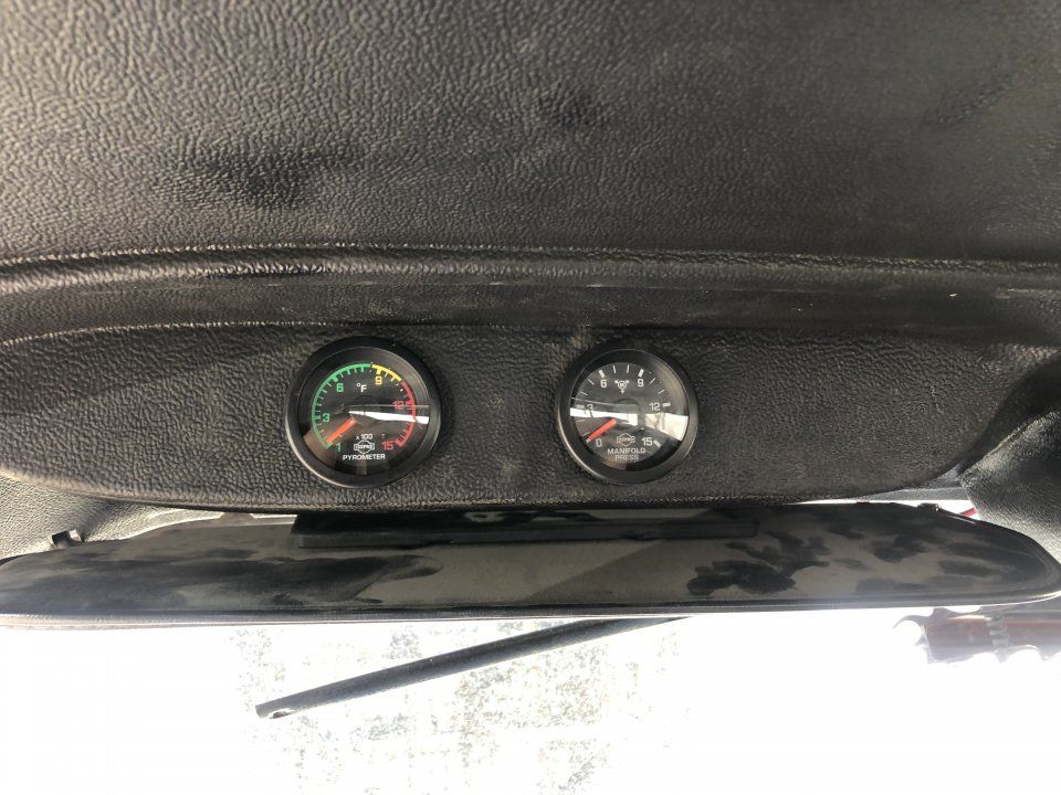

    Installed and wired up boost gauge and pyro gauge above top headliner.
    Successfully mated Summit Racing enclosed Airbox from Turbo to Snorkle.

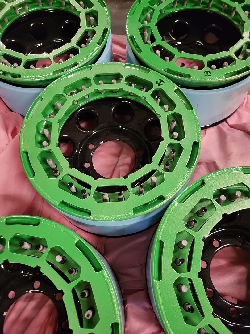

    Purchased Trailworthyfab beadlocks and old new stock hummer spare tire Goodyear MTR 37/12.5/r16.5 tires from Ebay.
    Mated with pvc insert and 10 oz of dynabeads each tire.
    Went to the junkyard and pulled a transmission cooler and installed it.
