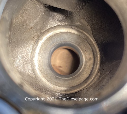

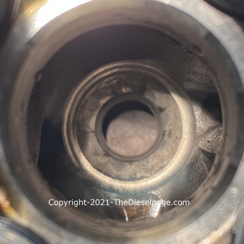

    Something new! I pulled all 8 of the injector cups from the heads in Lil Red. Seven of the cup seating areas inside the heads looked pretty much identical to the following image.
    I noticed while pulling the injector cups from this set of heads that they pulled quite a bit easier than they did from the heads in my GMC. It appears that there was very little sealant used on the cup tips when installed at the factory.
    The following cup seat image shows what looks like carbon tracks due to a combustion pressure leak. The stainless steel cup had matching identical discoloration on it as well. Sorry for the slightly out of focus image. It's hard to get the camera to focus that deep into the head. I should have used a pre-set focal distance setting on my DSLR with an F11 or smaller aperture, but I didn't want to fiddle with it (end of a long day). So, I used my iPhone. This is the #8 cylinder, where the slightly loosened head bolts were found. Possibly the result of the nitrous...

    That's an absolute indication of....something. Likely, at least, a contributor to your pressurized coolant. What's the origin of the engine? I'm sure we discussed it before, but I don't recall.

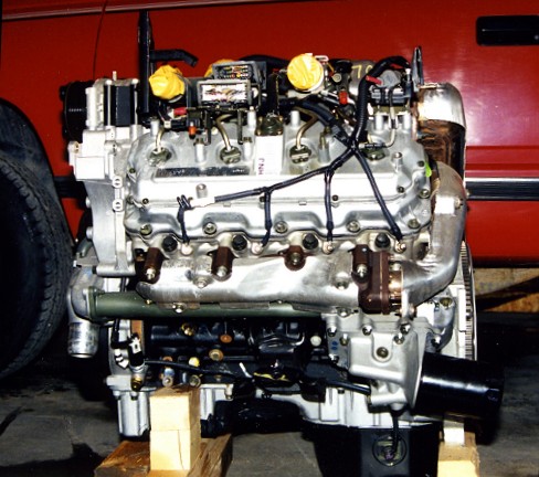

    Here's what it looked like when I received it from GM... after it was uncrated. The Allison it came with had been used in a test vehicle. The engine looked assembly line new, but I thought it odd that the glow controller hot lead had been clipped off. I received this engine in the spring of 2002. I had assumed this was a new assembly line engine - a 2002 model year, but it was actually a 2001 model year CA emissions engine. The glow controller and glow wiring is the main difference between a CA engine and a 48-state Federal emissions engine.
    It was at this point that I wish I'd clear-coated all of the aluminum components on the engine. So bright and shiny!

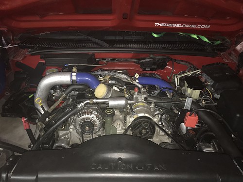

    Completed the 1,254th step (somewhat hyperbolic) in the process late yesterday afternoon. I had spent some time priming the fuel system using the hand pumping plunger on the fuel filter housing while using both the bleeder screw and the fuel test Schrader port. The engine started on the second 15 second cranking cycle. Purrs like a kitten. There were no check engine light or leaks. I was extra careful to make sure every potential leak source was properly installed and tightened before moving on to the next step.
    I shut it off, and spent some time looking everything over, then re-started the engine. Now, there was a service engine soon (SES) lamp. I shut it off, and looked under the hood for anything out of place. I found that the MAF electrical connector had become mostly unplugged. I straightened that out, which must have been due to not getting it latched completely, and the fact that I had to push and pull the air duct to get the new AFE air filter installed - all of which moved the MAF sensor around. However, getting the MAF re-plugged didn't turn off the SES. My Predator programmer won't communicate with this truck... it's married to my 2001 GMC, so I don't have a code to report. Does anyone know if a MAF code has to be cleared or does it go out on its own? Of course, I don't know for sure that the SES is due to a MAF code...
    However, the truck runs great! I drove it about 15 miles to warm it up and to burp the cooling system. Makes so much power! It purrs... And, no excessive pressure in the cooling system. Yay!
