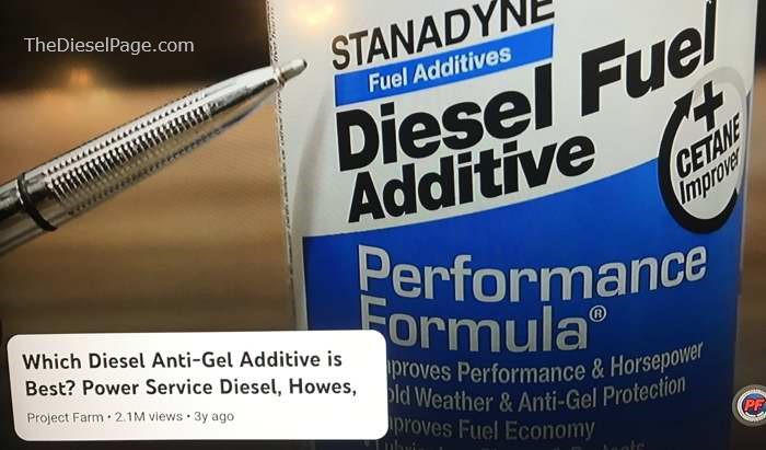

    I found this video a while back, but was reminded last week just how important fuel treatment and an anti-gel can be. We had temperatures just last week of a -42F windchill here in Montana. This is the best test I've seen, even though it doesn't include every diesel fuel treatment available. The results are surprising... Let us know what your experience has been with diesel fuel treatments...
    https://www.youtube.com/watch?v=n8gDN_6esfs

    I have only ever used Howes and Power Service due to easy local availability. Seems like Power Service does a better job at preventing gelling than Howes does. I had no issues during our cold snap last week with wind chills close to 30 below; I did double up on the amount of Power Service I normally would have used. I know of at least one pickup and one tractor that gelled up using their "normal" amount of additive.
    I would like to give the Stanadyne treatment a try.
