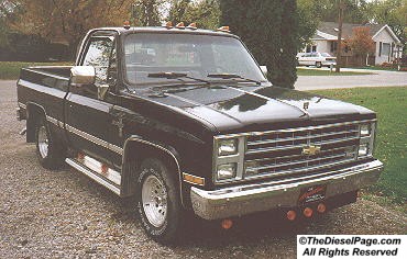

    My next GM diesel vehicle was a 1987 R-10 2wd short box 6.2L diesel pickup purchased in July 1990 for $6500. It had 78,000 miles on it when purchased. It needed a little TLC when I bought it. Underneath was full of mud, shock absorbers were shot, needed fresh rubber, and TCC lockup didn't work. But the engine ran well. I owned the truck several years, sold it to my oldest brother, then bought it back from him a few years later, then sold it back to him a few years later. He had owned it since then but has recently sold it, with well over 200,000 miles on the odo. Still has original injector pump and 700R4 transmission. A couple water pumps, 2 starters, and 2 alternators, 1 glow controller, and 1 set of glow plugs were the only components replaced on the engine, AFAIK. Averaged 20mpg all the time with this truck.

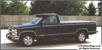

    My next GM diesel was a 1995 Chevy C1500 2wd standard cab long box 6.5TD purchased new in February 1996. This truck was featured in The Diesel Page with a review of the BD Power Chips. It was also one of the first diesel pickups to have an A-pillar Gauge Pod with boost/pyrometer gauges. I also installed a Banks exhaust system on this truck. I owned this truck until November 1998, when the Chevy was traded on a nearly new 1999 Ford 7.3 PSD (I could write a novel on that Ford LOL). The only major problem with the 1995 Chevy was the injector pump. It came with a blue tag pump from the factory, and the dealer replaced it with a green tag pump.

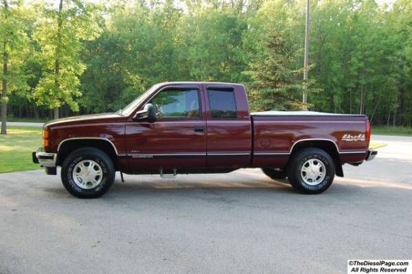

    My next GM diesel is a 1995 GMC K2500 Extended Cab 4X4 6.5TD with 116,000 miles purchased in April 2002 from a local dealership. The truck had no power and was popping through the intake. Well I rescued this truck (dealer took a big $$$ loss) and my neighbor towed me home. Major problems discovered were a plugged catalytic converter and a broken push rod on Cylinder #1. I installed a used pushrod and a new 3-1/2 inch Kennedy Diesel exhaust system, and the truck ran much better. I fished the mangled push rod through the oil pan drain hole.
    I have done many mods to this truck, and it is my daily driver to/from work. It currently has 154,000 miles, and runs quite well. Does have a slight tick/knock from time to time. Modifications:
    Kennedy 3-1/2" Exhaust
    TurboMaster Wastegate Controller
    Custom Tuning using Wester's OBDI Software
    Kennedy Headlight Booster Harness
    Kennedy FSD Cooler w/ extension harness
    Trailer Tow Mirrors
    Tonneau Cover
    Michelin LTX LT265-75R-16 LRC Tires
    Amsoil Bypass Filter with Rotella-T Synthetic 5W-40 Oil

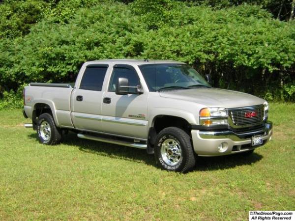

    My next GM diesel is a 2005 GMC Crew Cab SB 4X4 Duramax/Allison, purchased new in July 2005. Currently has 32,000 miles as of July 2007. This is my recreational vehicle, driven primarily on the weekends. Of all the GM diesel trucks I've owned , I prefer this truck the most.
    Modifications so far:
    Custom Tuning with EFILive
    EGR Blocker Plate
    ISSPro EGT/Boost Gauges on A-Pillar Pod
    DIY Cold Air Intake
    Amsoil Eaa Air Filter
    Putco Stainless Steel Tube Grill Insert
    Putco Stainless Steel Box Rails
    Truxedo Tonneau Cover
    Michelin LTX LT265-75R-16 LRE Tires
    06 Towing Mirrors
